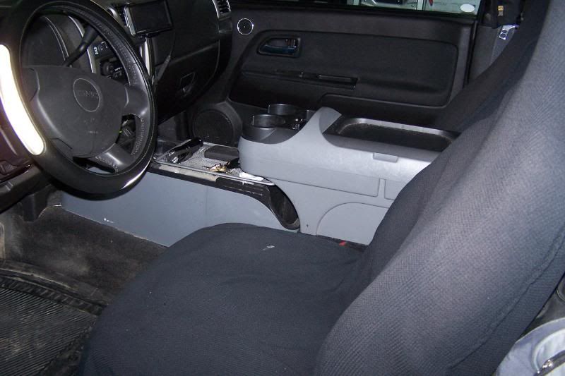

Thanks for the instructions for the removable, you will save me some detective work. Don't have my Canyon just yet, but I plan on repeating the same set up as on my 2010 Ext. Cab. I just removed everything tonight, so I took some pictures of my previous set up.. rather simple.
Loaded
Toolbox drawer
Base
What was actually in the cab
Ignore the first 2 bins.. they were actually my console
