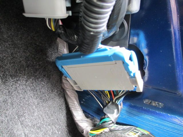

If that doesn't help, find this connector, behind the right kick panel. Disconnect it and check the condition of the terminals:
If the problem persists, post back.

I did remove the wiring connecting harness that connects into the bottom of my resistor to inspect it and there are a few pins (I believe it's like a 4 pin connector) in the middle of the female end that appeared to be darkened, and MILDLY appearing to be burnt out pens, but not majorly blackend and clearly burnt out like many pictures i've seen on threads of people who are experiencing similar issues but they still normally will have the highest speed setting where as i have ZERO speed setting. so this still leads me to believe it's not that connecting harness......but then again could it be?????

If you replaced the blower motor yourself, you shouldn't have any problem checking the places that I posted previously. You are not the first person that has had blower motor problems, however most of the guys had some understanding of electrics. In your case, I suggest that you follow n9cv's suggestion to determine if the problem is on the ground side of the circuit. If it is a "ground" problem, you will need to find out just where it is at. The two locations that I gave you in Post #2 are the most common areas and do not require any electrical knowledge or tools to check. If you need help getting access to the connector, post back.
