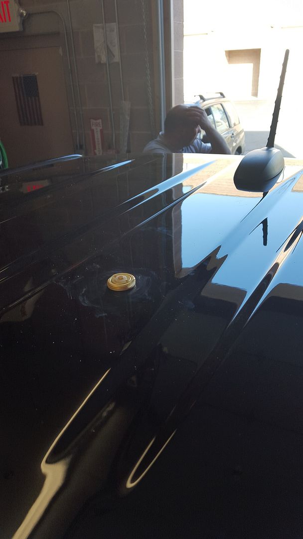

If you are starting with 2m/440 then there is not much to it Make sure you have a good (short lead) ground at the base of the radio and if possible also a the base of the antenna. While wiring direct to the battery is a good idea, I seldom find it necessary on 2 meters with only a 50 or 75 watt transmitter. The center of the roof is alway a good choice for a 2 m/440 antenna. Mine barely rubs the garage door at home and only drags in one place overhead in the local casino garage. If I was not a Z71 I would not hit in either location.
