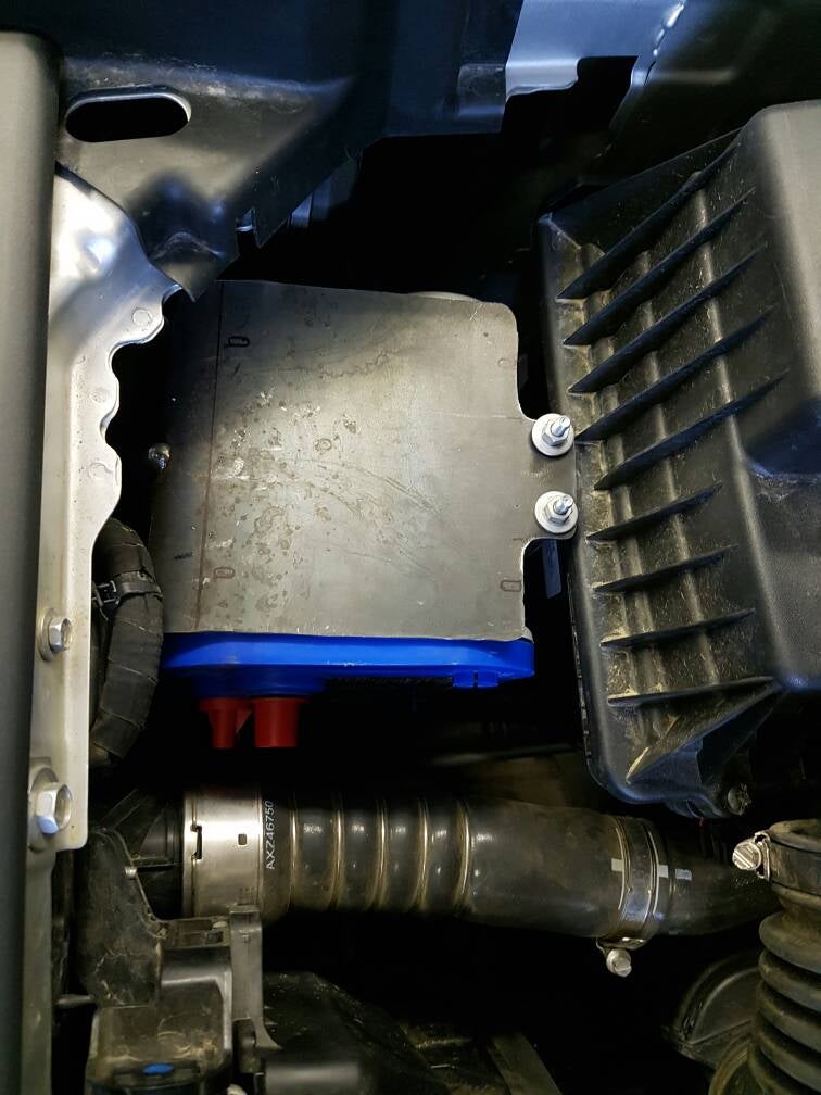

Had one of these installed in my 2008 2500hd hooked up to my cellular command start. Was awesome, able to start it and ran it for an hour or so, would use about a liter of fuel to bring it up to temp, have instant heat when starting the truck at -35*C and it would keep the truck closer to the operating temperature than the truck would get to at high idle.

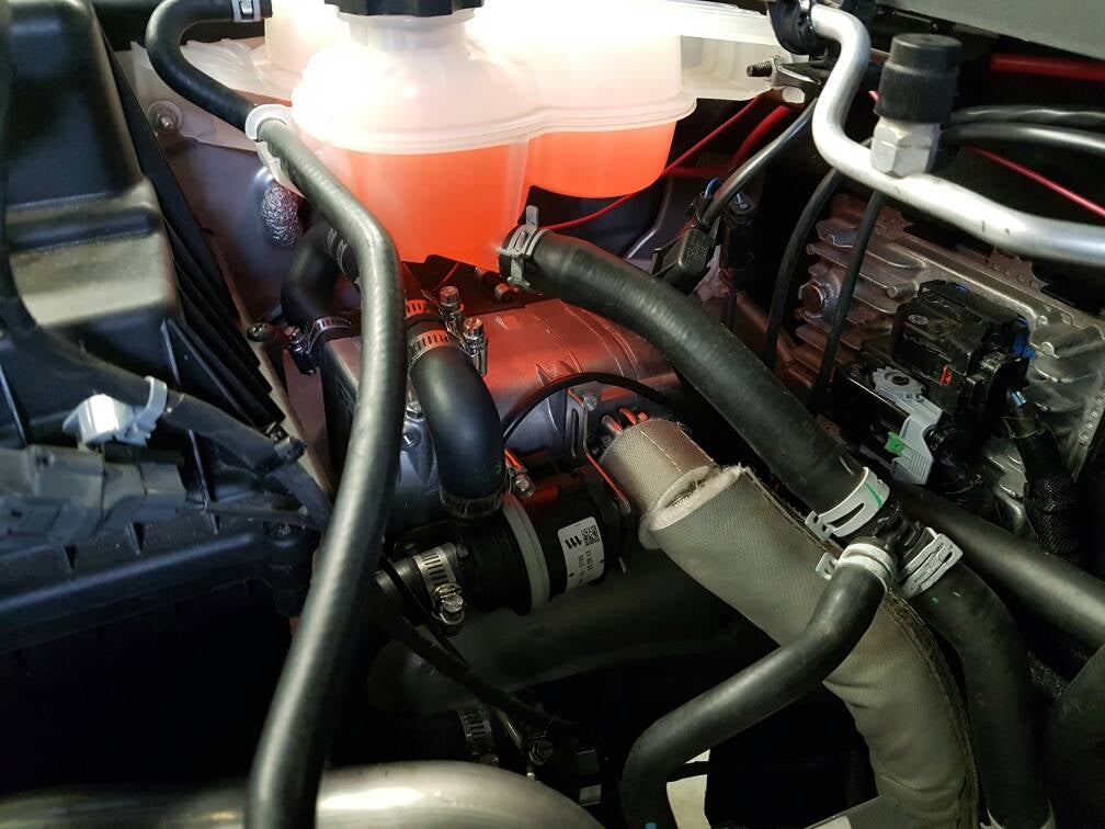

Since they can be mounted in any position I put mine under the coolant container. I wanted to keep the coolant lines as short as possible.

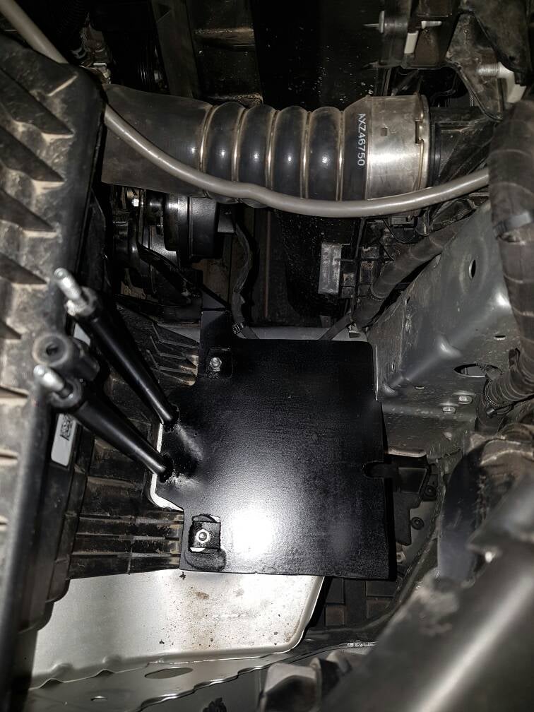

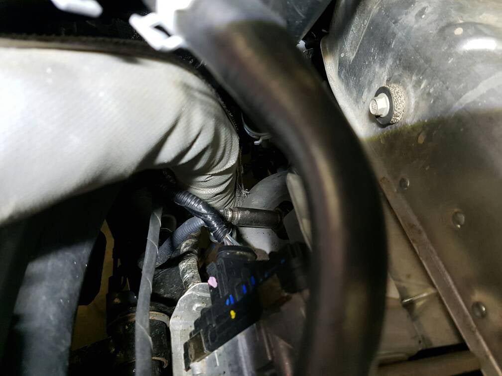

I then changed the routing of a wiring harness and ran the exhaust tube down to the flex pipe. This is insulated to reduce the chance of damaging any wires that are in close proximity. Outer sleeve on insulation was only 38*C after an hour of running tonight.

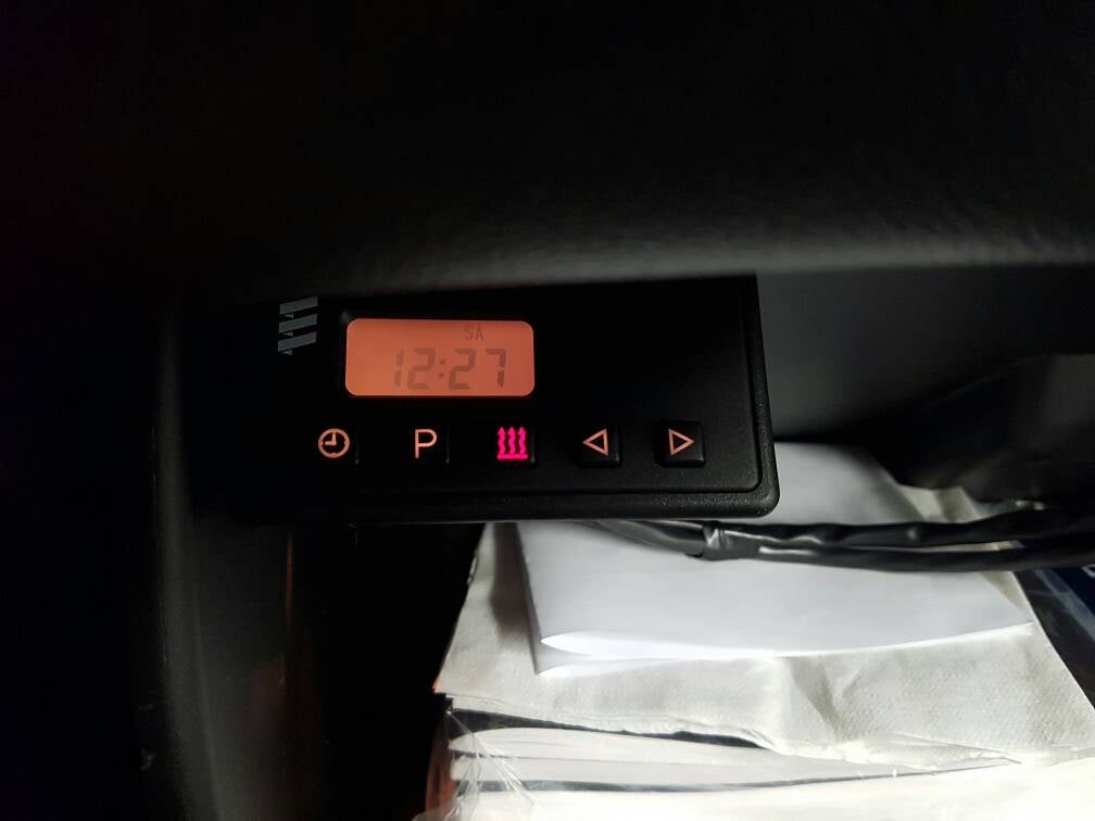

The timer is mounted in the glove box. Basically for me this is useless other than retrieving codes for when it doesn't start.

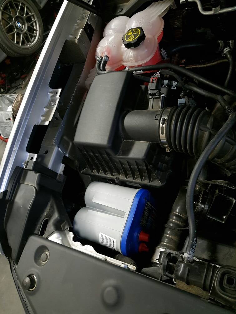

To help with any low battery voltage/capacity issues I added a second battery under the hood too. It is an optima D34M I believe. Had to relocate the horns just below the bracket so they are beside the frame. Also there is a wiring harness that had to be moved higher a few inches to make room for the battery. To make this battery fit a couple of fins had to be trimmed on the front mounts of the air box. The air box is still totally sealed and no extra holes or modifications were done to it.
There is a battery isolator mounted on top of this plate. Also there is 3/16" of rubber below and on top of the battery.
