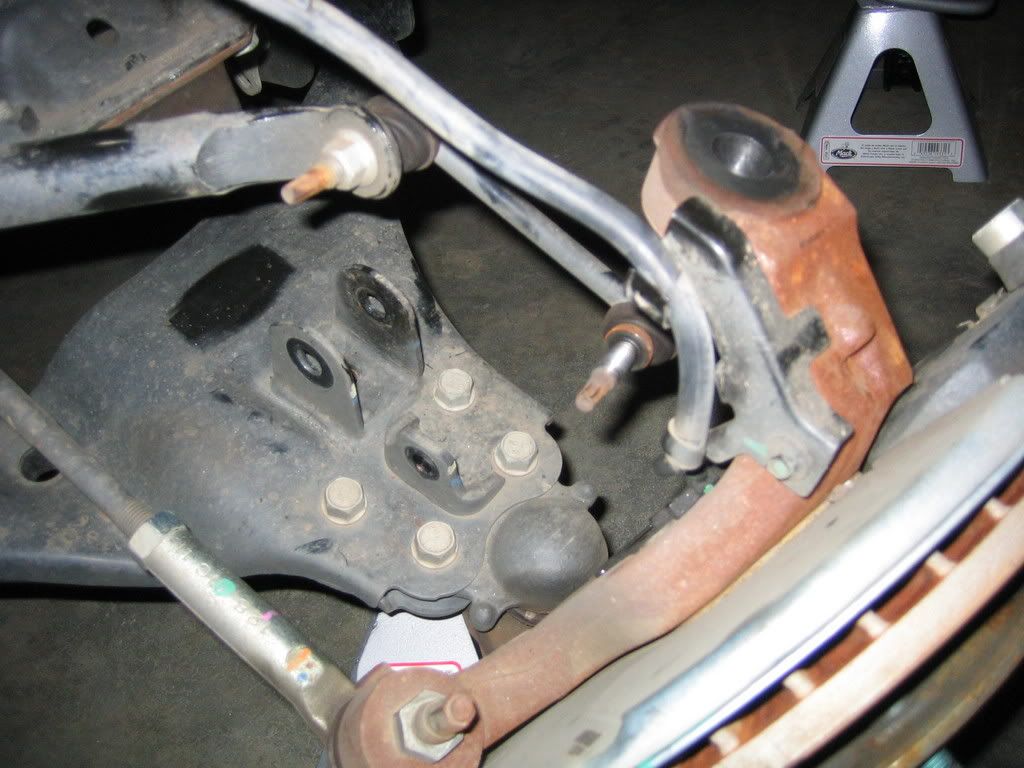

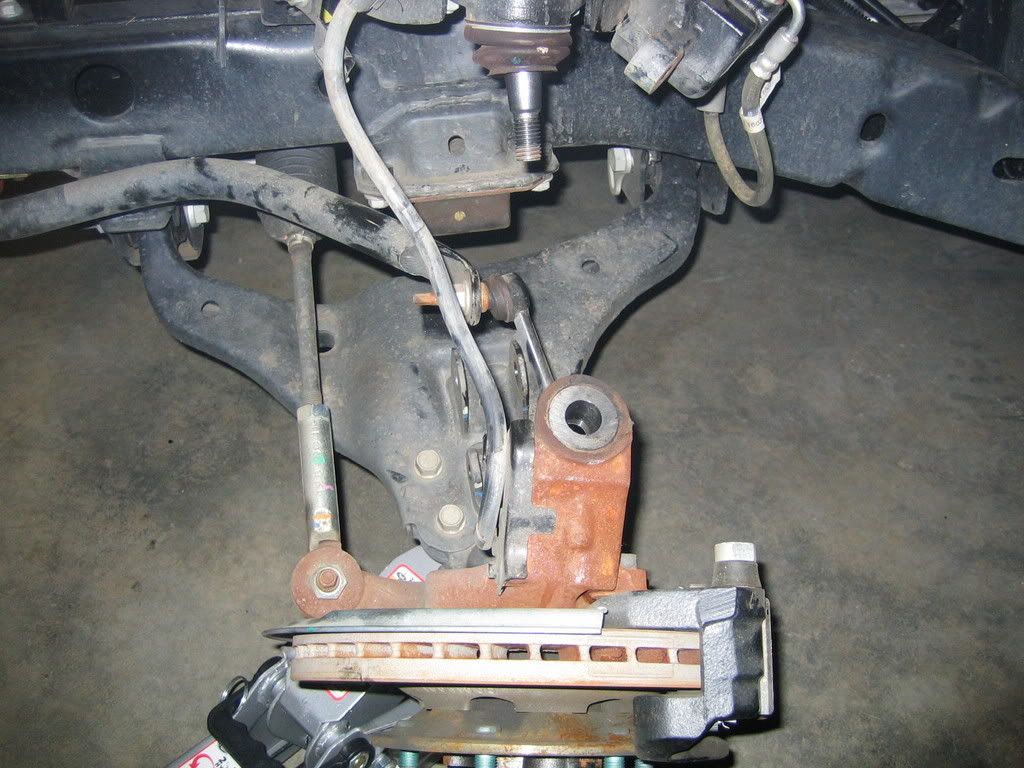

4. start on drivers side, remove the sway bar link
5. remove the lower bolt in the strut
6. remove the upper 3 nuts for the strut, easiest when dont with a ratchet wrench(at this point I have heard of people being able to remove the strut) but in my case I had to
7. unbolt and seperate the lower ball joint from the spindle

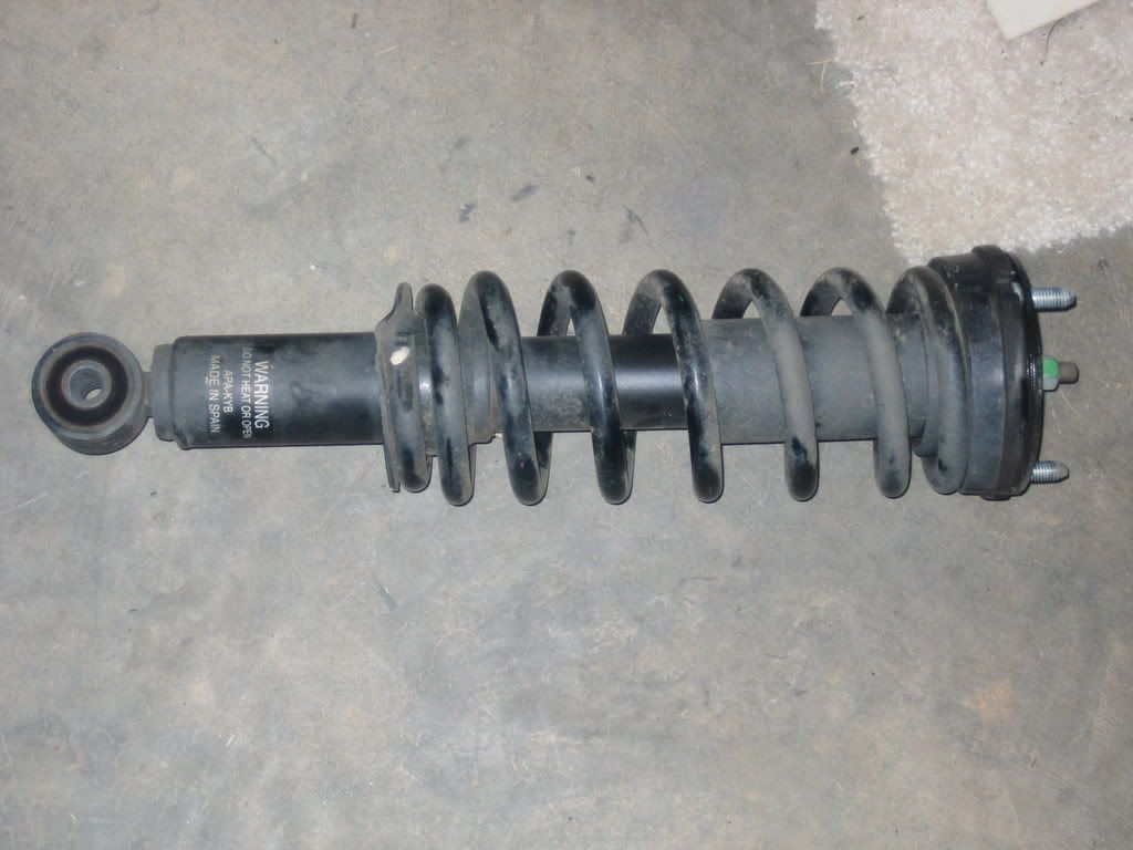

8a.either use a spring compressor to compress the spring and loosen the top nut on the stud(using a ratchet wrench and an allen wrench) careful not to strip it.
8b. take it to a automotive shop and have them do the swap(they have all the right tools for this job)
*make sure you see the alignment of the top studs to the bottom
eyelet(have to keep it lined up or you cant get it back in)

Here are some general pics of my 05 coly in process will add better step by step pics later, but this will work for now
