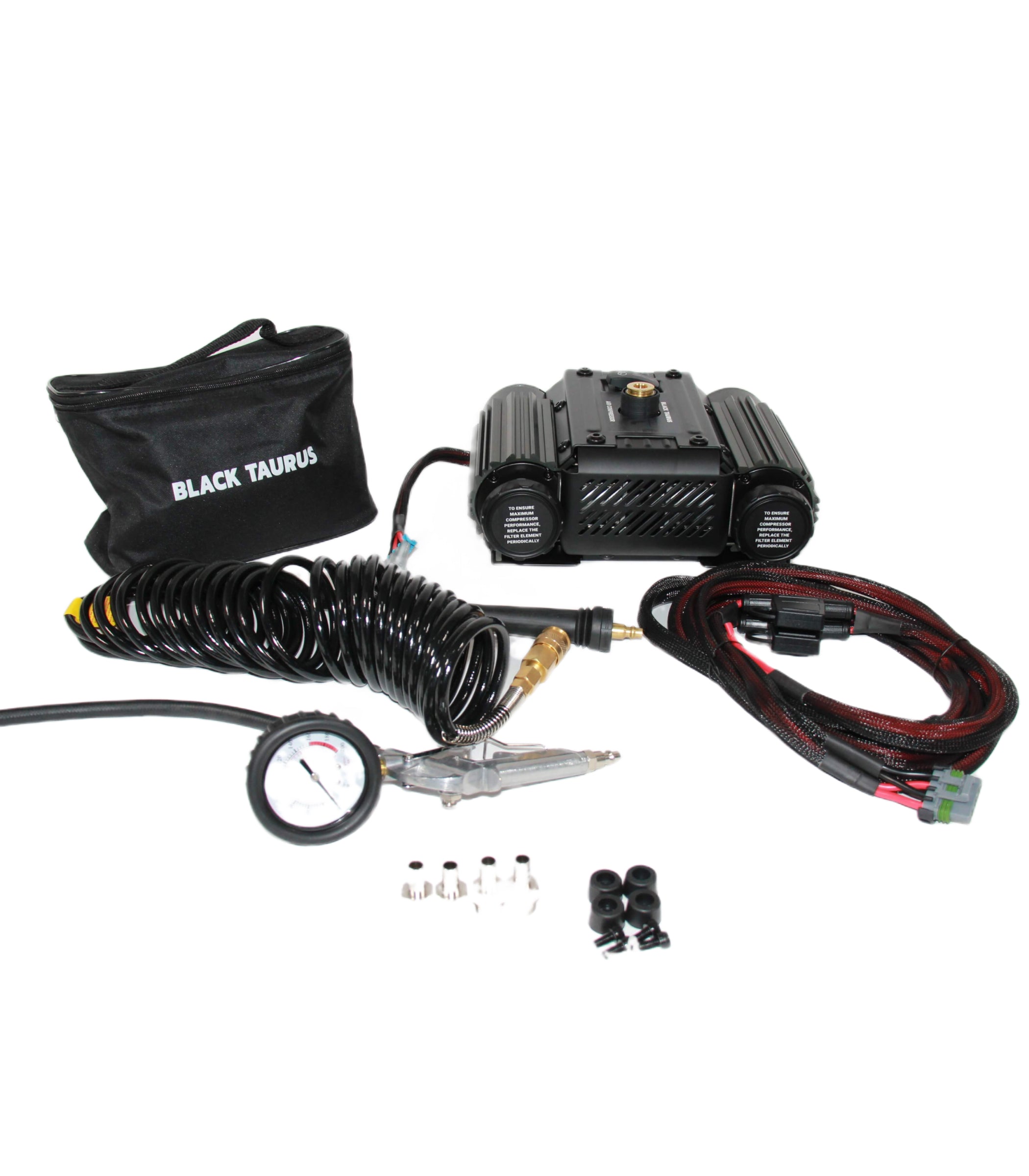

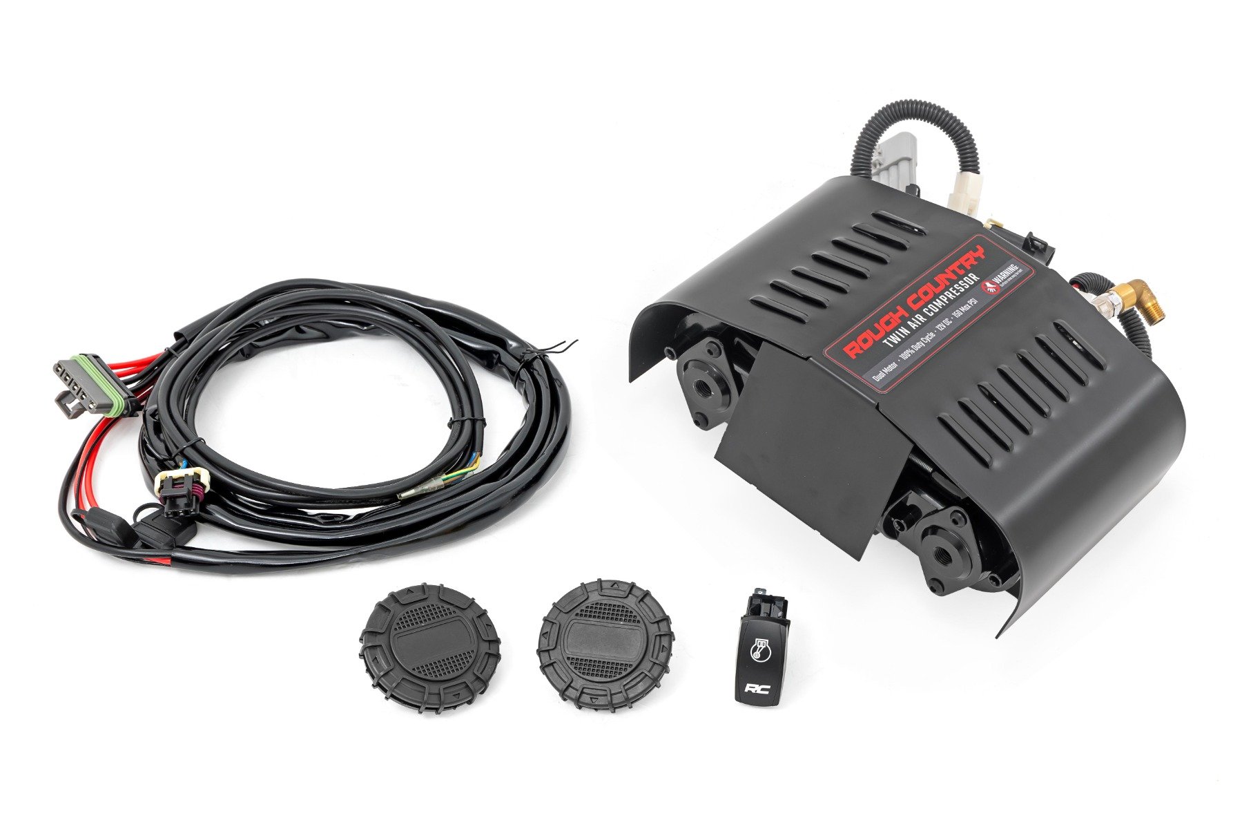

All the 10.6/5.6 CFM 50% duty cycle compressors are probably the best bang for your buck (MORRFlate, EZ Flate, SSW, Thor's Lightning, Overland Vehicle Systems, Rough Country).
The next level up is probably the Rough Country twin, or Black Taurus twin. These are 100% duty cycle compressors.
