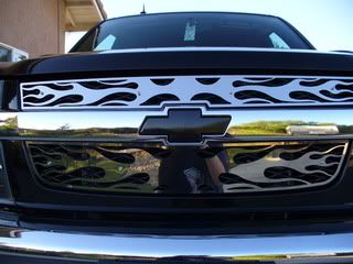

Here's what my truck looks like now.

mililani00 said:
whats that on ur last pic.? is it coming off?
looks like a reflection

yeah it was a reflection, and yeah i would recommend roughing it, mine already was a little roughed i dont know if you could see that in the first pic or not... but it turned out pretty sweet. posted a new pic, and it's pretty well on there i washed my truck today and scrubbed it with soap to test how durable it was, did nothing. i guess time will tell.
