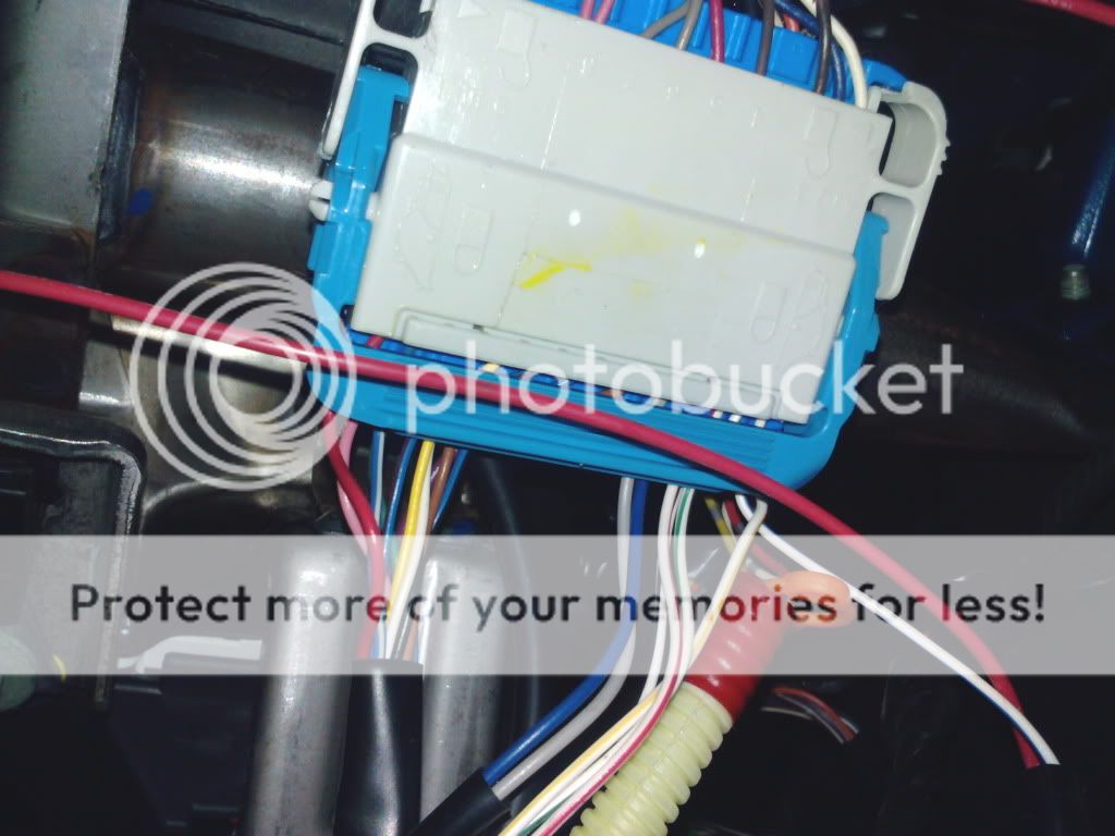

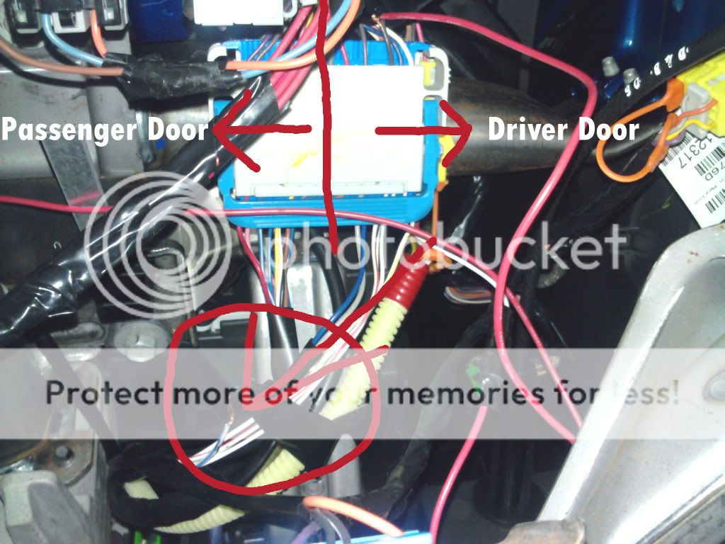

Step Two: Locate the plug pictured below, The plug is under the dash near the steering column. Open your driver door and stick your head on the floor near the gas and brake pedal and look up, it will be the big white plug staring you in the face. If you need anymore help let me know. You will notice that on the side closest to the front seats, the plug is pretty much split in two. We will be working with the right side of this plug. We are looking for the wire that is White with a BLUE stripe. It will be with other wires that are white/colored stripe.
Step Thee: Cut this wire in half, and electrical tape both ends.
Step four: Shut off the truck, You’re done!

yep, this is more for people that can't disable passlock or vats because they dont have access to hpt.

Just did it to my 2006 colorado and is working just like author said, but be careful in the low light the stripped green/white wire looks exactly like the stripped blue/white wire. Wish I could buy you a beer in gratitude.
