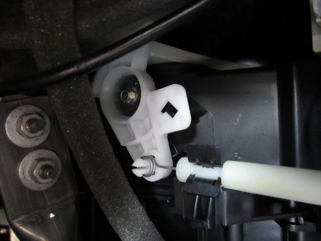

You can check the end of the temp control cable by opening the glove box door, pushing in on the stops and lowering it all the way. Look in and to the left and you should see this:
Notice the outer sheath in the retainer.

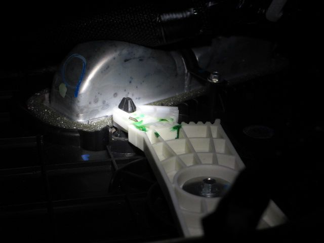

To check the bellcrank on top of the case you will need to remove the trim around the radio/HVAC control. I can't remember if the radio or the HVAC control will have to be removed for visual access, but this is what you should see. One of the pics is full cold position and the other full hot. Just check the position of the teeth.
I don't have pics of the cable installation on the back of the HVAC control, but the connections should be similar to the connections at the bellcrank.
